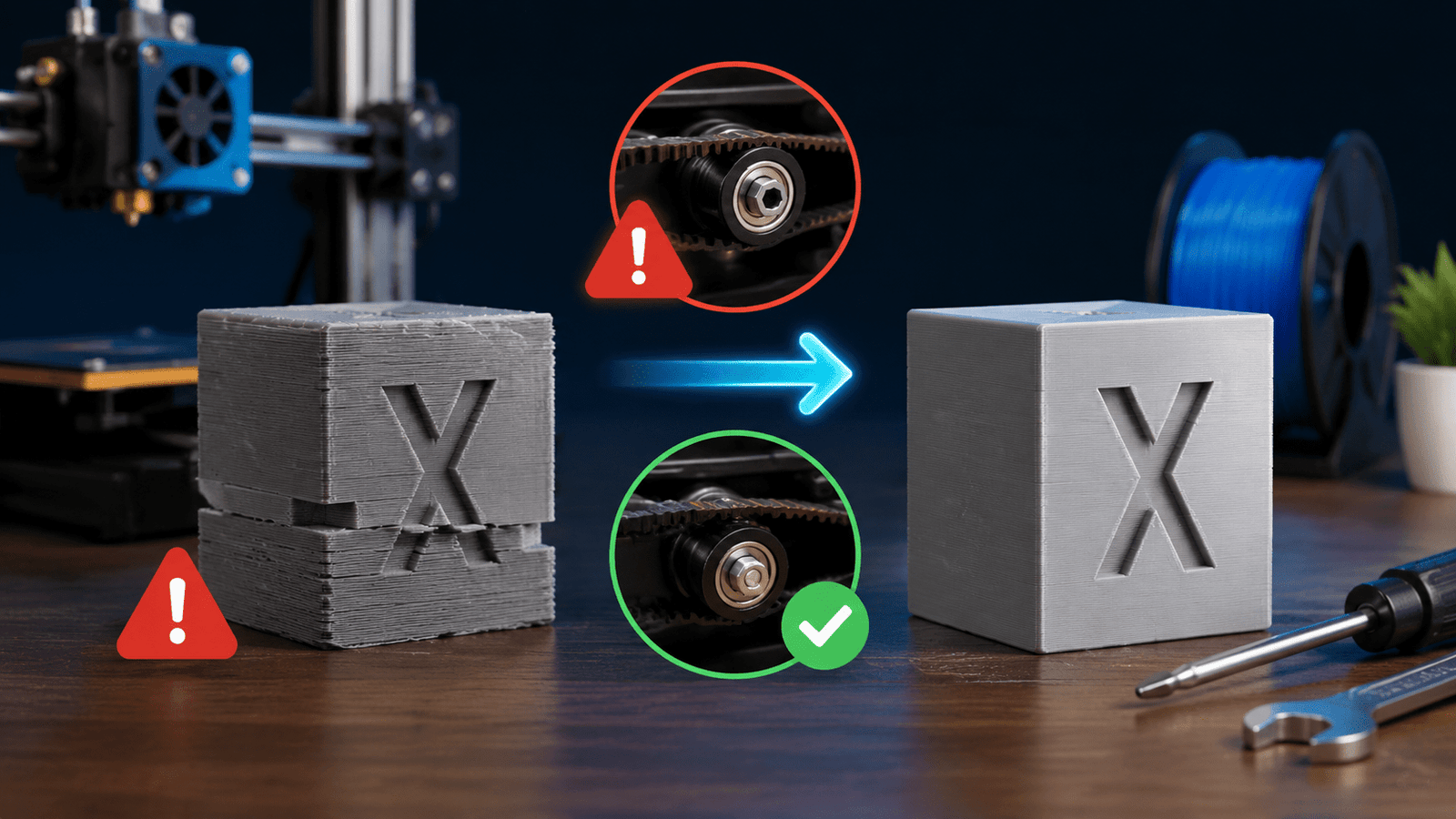

This is the example of a layer shifting 3D print.
Layer shifting, in other words, known as layer misalignment, is when the layers of the print are not properly aligned, and the print can be unsightly(mostly a failure). It is a common issue in 3D printing and can be tricky, especially if you are a newbie. This article will walk you through the possible causes of the problem and how to fix it accordingly.

Mechanical disorder
Most 3d printers use belts to let the motor control the position of the nozzle. Over time, the belt may stretch, which can impact the tension used to control the nozzle. If the tension becomes too loose, the belt may slip on the pulley, which means the pulley is rotating, but the belt is not moving. If the belt is too tight, this can also cause problems. Tightened belts can create excess friction in the bearings that will prevent the motor from spinning. Ideally, the belt is installed tight enough to prevent slipping, but not too tight to stop the system from rotating.
Mechanical disorder, take Mizar M as an example
Solution: manually adjust the belt for proper tension. Regularly check and maintain your 3D printers.
