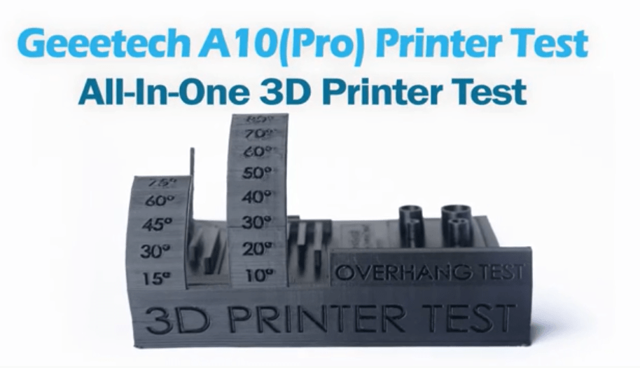

All-in-One 3D printer test
This test includes a support test, scale test, overhang test, hole test, diameter test, and bridging test. It is printed with 100% Infill without supports.
45 degrees is said to be the critical angle for overhangs without any support, but here we have an 80-degree overhang with no support. The overhang and bridges are printed with no signs of sagging or drooping.
All-in-One 3D printer test model
The clear and sharp corners show no signs of stringing or deviations.
