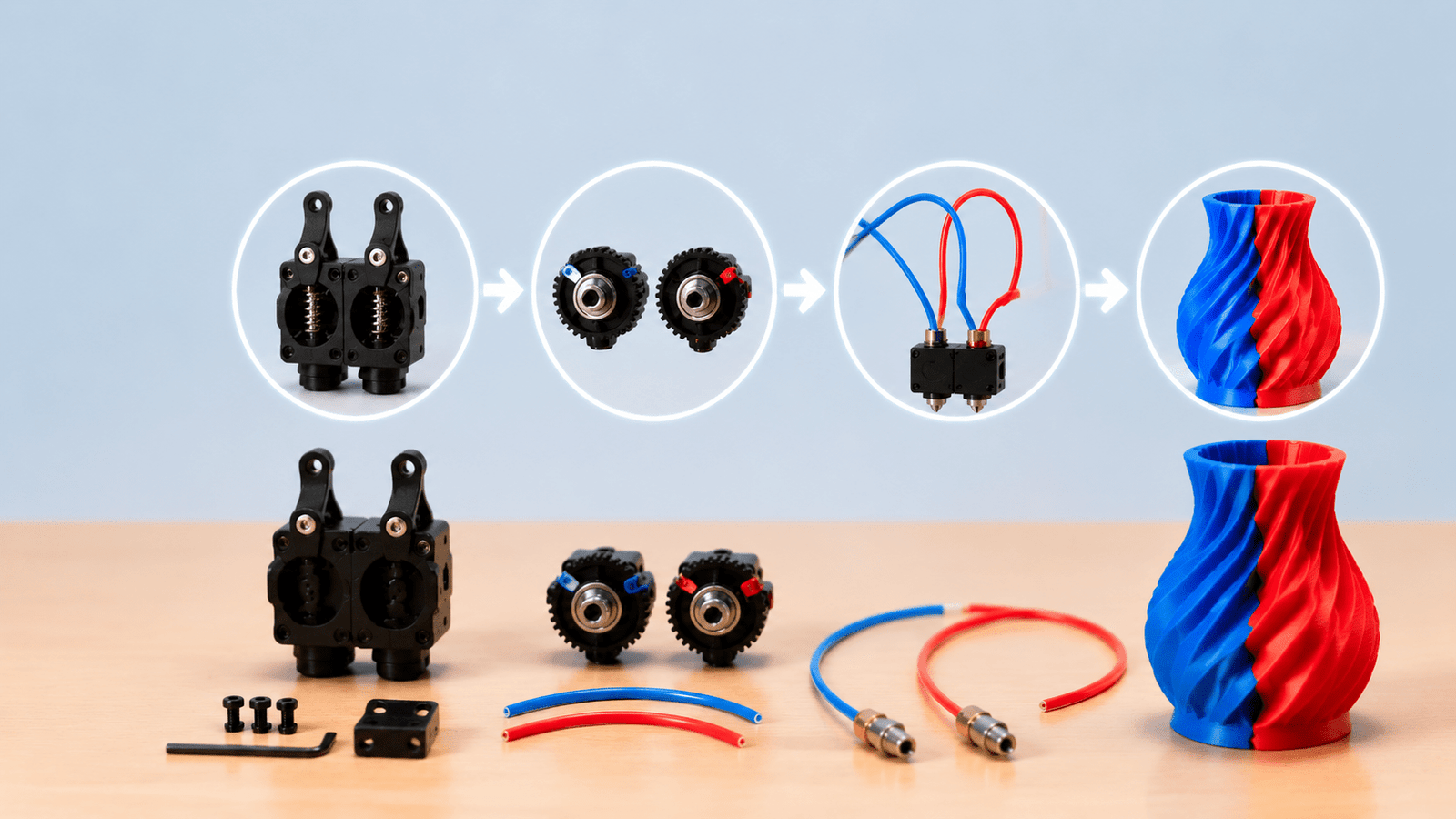

Leveling the two extruders.
Leveling the two extruders is very important if you want to print with two extruders at the same time.
First, you can adjust one extruder to make it parallel with the surface of the heated bed (the same way you level for a single extruder setup), click the button of Z home to adjust the distance between the nozzle and the heated bed, make sure the vertical distances of the nozzle to the four corners of the bed are the same.
After that, tweak the distance between the second extruder and the heated bed by adjusting the screws, as shown in the following picture: Loose the screws, and then you can move on to get the right distance between the two extruders and the heated bed.
you may need to repeat this step to get it all right.
But it’s worth it. Once you get it done correctly, you won’t need to do it again.
