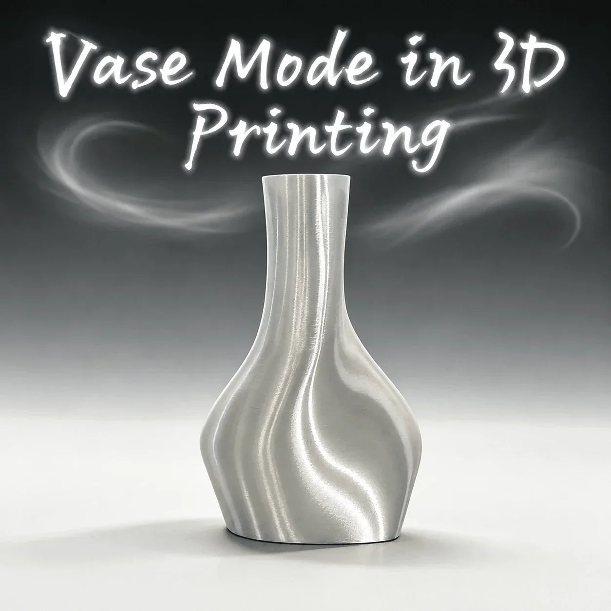

What Is Vase Mode in 3D Printing
Vase mode in 3d printing
Vase mode, also referred to as spiral vase mode, is a unique method of 3D printing that is meant to print hollow and thin-walled objects with a smooth exterior finish. Unlike other 3D printing methods, which print in layers and have defined beginning and ending points, the vase mode makes use of a smooth motion in which the printing never stops and continues moving upwards in a spiral motion.
The Concept of Vase Mode in 3D Printing
Traditionally, a layer consists of perimeter, infill, and top layers. However, in vase mode 3D printing, all the infill and top layers are removed, and only a single wall is left. Instead of adding layers, the nozzle moves up in a spiral motion. Spiral 3D printing or 3D print spiral vase are frequently used to describe this technique.
The main principle behind 3D printing vase mode is efficiency and aesthetics. For example, the actual object, say a spiral vase, will have a very smooth finish since there are no layer changes and no Z seams. It will also require less filament, making it faster and cheaper to produce than traditional printing.
