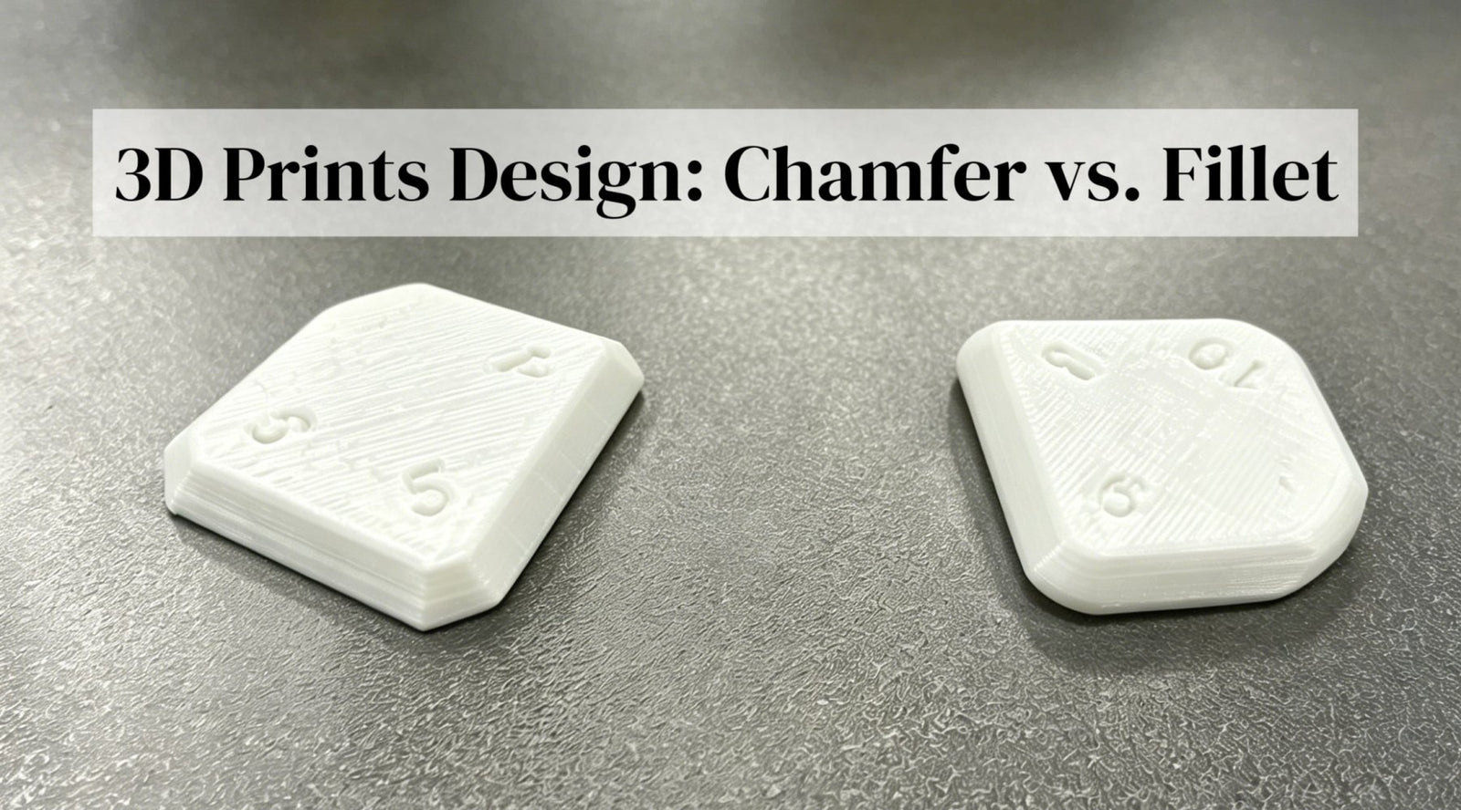

Every sharp corner you encounter while creating components for FDM 3D printing offers you a decision: leave it as is, chamfer it with a bevel, or fillet it with a curve. In the setting of FDM 3D printing, this guide describes the main distinctions between fillets and chamfers and their effects on printability, strength, and beauty.
