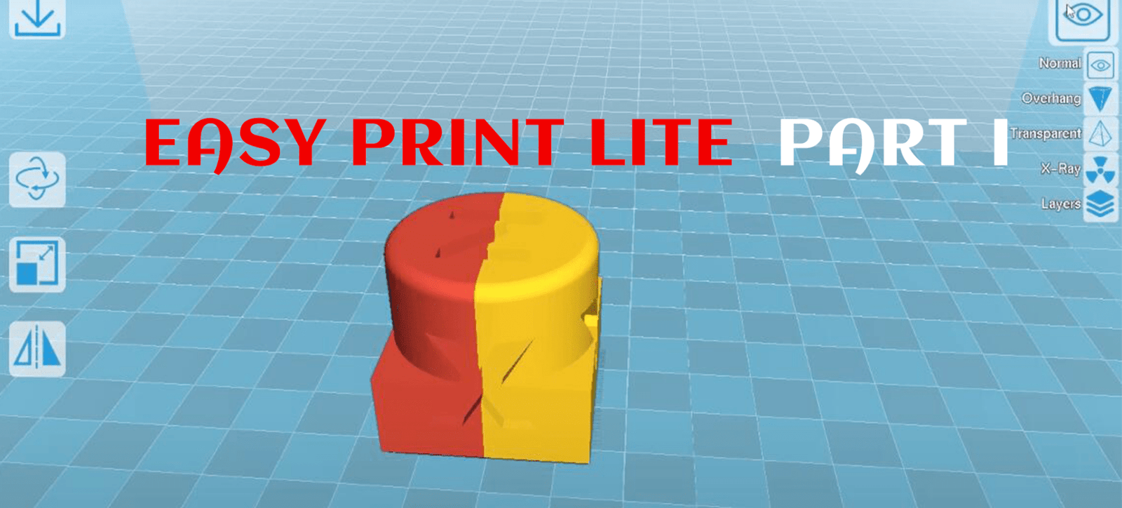

As we all know, slicing software is definitely a must-have for every FDM 3D printer lover. We’ve got various software now surging in such a marketplace for assisting users in slicing models, like Cura, Simplify3D, Repetier-Host, Slic3r, and EasyPrint. The slicing software, also named as slicer, converts the 3D model into a G-CODE file that will provide the 3D printer with all the necessary instructions for printing.
In this article, I would love to make a detailed introduction to the EasyPrint slicing software developed by Geeetech R&D Department. With the newly updated version of the functions, EasyPrint Lite now allows users to print models with multiple colors. For the color matching process, detailed steps are as follows (Take A10M and A10T as examples):
