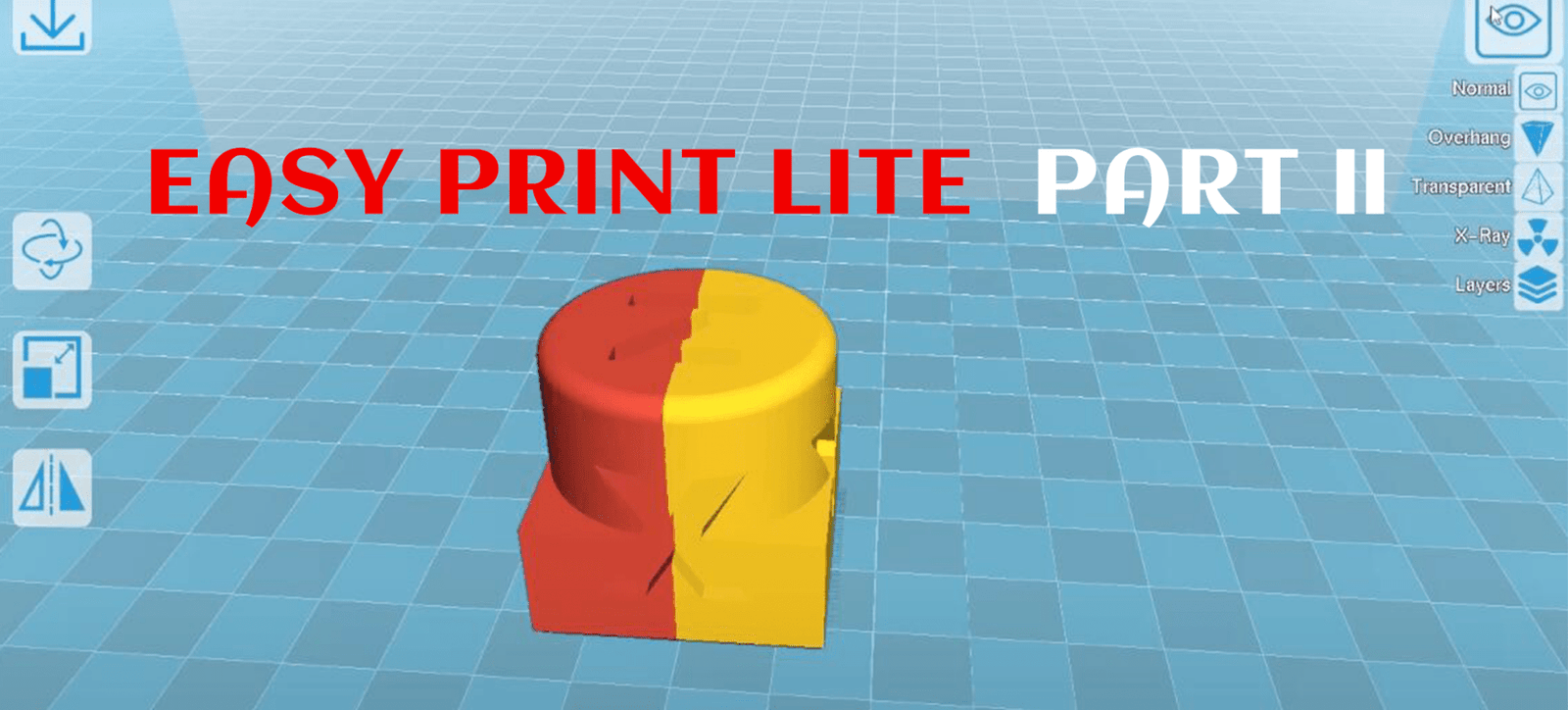

EASY PRINT LITE | A 3D Printing Slicer For Color Mixing Function of Your 3D Printers (Part II)
Besides the color merging with separate modular of different colors, the updated version of our Easy Print Lite also allows you to print your models with gradient color which requires only some simple steps. Let’s dive in and see where it will bring us.
