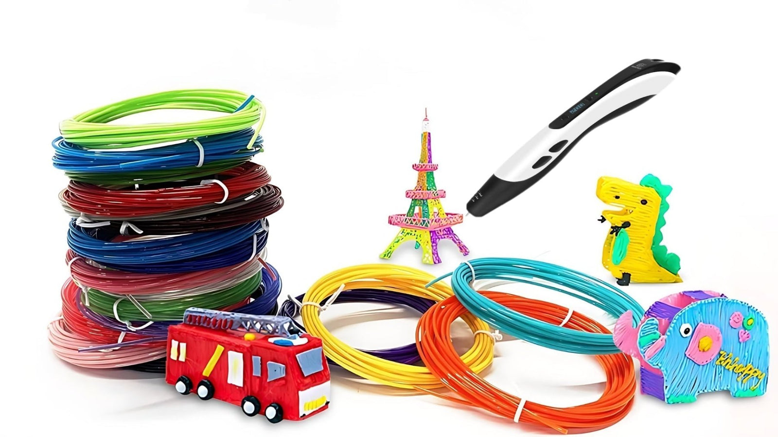

The Ultimate Guide of 3D Pens
Creative printing with 3D pen
If you are looking to play around with 3D printing in real-time, one of the easiest and most accessible ways is to try a 3D Pen. These small devices allow you to heat up 3D printer filament and then create your own and unique designs by simply drawing what you want. Learn all about it here!
