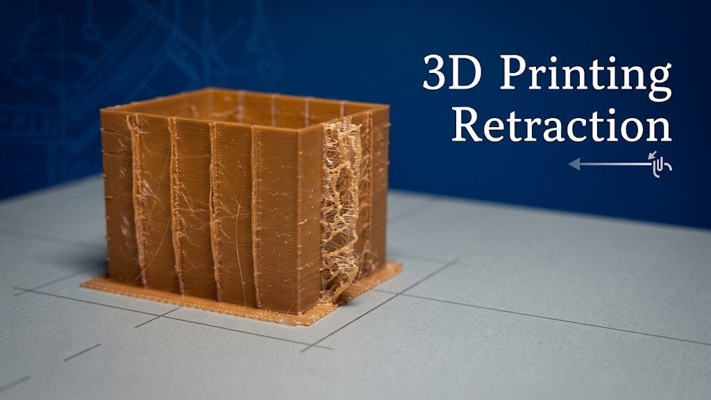

Stringing / Oozing
Once you have seen this problem in your own prints, you will understand both of the words instantly. Stringing and oozing are what happen when you get long, thin lines of filament that do not follow the expected layer pattern. They can be caused by a number of different things, but relating to retraction, there are typically three main reasons.
Stringing can happen because the retraction distance is not great enough, which is the most common issue people have. As we mentioned earlier, if the filament is not pulled far enough back into the nozzle, the filament can leak out.
Another issue is that your retraction speed is too slow. If the retraction is not quick enough, it won’t relieve the pressure in the nozzle effectively to allow the molten filament to stretch and turn into long strings.
While not strictly a retraction issue, you can also experience stringing if your print temperature is too high, as the filament becomes more "runny" and prone to stringing.

How to Run Retraction Tests to Find the Perfect Values
In order to find the best values, whether for your TPU retraction settings, or PLA retraction speed, you follow this step-by-step guide to dial, in order to learn how to reduce stringing 3D printing artefacts.
Retraction Test
Retraction Test ( PLA Filament )
  1. Dry filament: This is very important because too much moisture may give you a lot of stringing and poor extrusion.
  2. Print a temperature tower: You can try to print a temperature tower that gradually changes the printing temperature according to the height of an object to find an optimal value. This can help identify the best extrusion temperature for your specific filament.
  3. Use a retraction tower:  Next, you can try a specific retraction tower model to help you adjust the distance at a fixed speed. As the printer goes layer by layer, you will then need to observe the distances that produce the least amount of stringing.
  4. Fine-tune the speed: Now, you know the retraction distance, you can lock that in and then work on the speed. Print another retraction tower to see what speed works best.
  5. Record the perfect values: Don't forget to write down your best values for future prints. They can also help you when changing to another brand or even trying PLA retraction settings instead of ABS.
