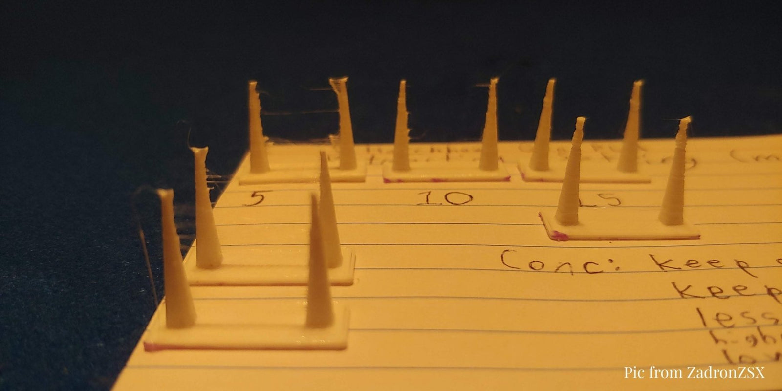

3D Printing Stringing exists when small plastic strings are left behind on a 3D-printed model. This is usually due to plastic leaking from the nozzle as the extruder moves to a new position.
Finished print affected by stringing
