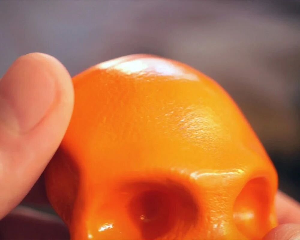

Fortunately, we can refer to 3DSage’s unique method of getting a beautiful look without using sandpaper.He printed a model of the skeleton as a demonstration. All you need is a can of spray paint that combines well with plastic (such as Rust-Oleum) and a bottle of Fast Drying Polyurethane – Clear Satin. Let’s get started!
smoothed PLA model
3DSage shares the Skeleton model that he uses in his own example
The first step is to check whether there is dirt or dust on the 3D printed model and make sure there is nothing superfluous on the surface.Apply a spray paint of your choice to the model, followed by a quick coat of polyurethane.
Next, to make the coating dry faster and prevent drips, you should carefully place the model under the fan.At this point you can see that the mixture of paint and polyurethane will blend into the layer, making up for any holes or unexpected imperfections and working best with thin layers and patience.3DSage said he waited for a whole day before adding the final coat of spray paint.And the time interval between layers is 20 minutes in order to prevent discoloration and make up for defects.
Put the coated 3D print under a fan to make it dry faster
When it comes to the benefits of his craft, The Maker says it allows him to print faster with a greater layer thickness.This process will mask any rough and unsightly appearance.And you can choose any color of paint.In this way,you get a smooth print model that doesn’t require polishing or other post-processing techniques.
