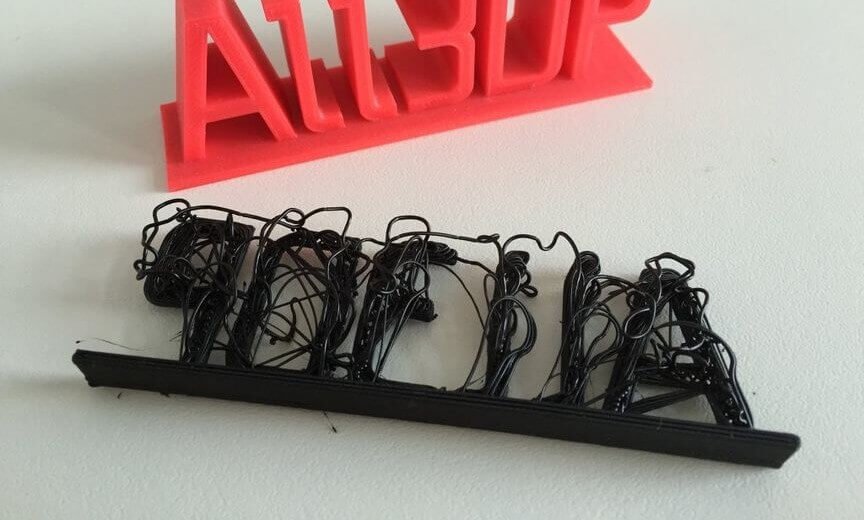

3D Printing Problems #1: Blocked Bowden Nozzle
Common 3D printing problem shown on a test print
What’s the 3D Printing Problem?
You initiate a print job but whatever you try, nothing comes out of the nozzle. Extracting the filament and reinserting doesn’t work.
What’s Causing the 3D Printing Problem?
A small piece of filament has been left behind in the nozzle after changing spools, often because the filament has snapped off at the end. When the new filament is loaded, the piece of old filament that is left in the nozzle doesn’t allow the new filament to be pushed through.
Alternatively, a build-up of molten plastic at the end of the nozzle has hardened and will need manual removal. Specialist, cheap, or old filaments are a common cause.
3D Printing Troubleshooting: Blocked Bowden Nozzle
  1. Unblock with a needle. If you’re lucky, then unblocking can be a quick and easy process. Start by removing the filament. Then, using the control panel select the “heat up nozzle” setting and increase it to the melting point of the stuck filament. In the case of the Ultimaker 2, go to Maintenance > Heat Up nozzle. For PLA, set the temperature to 220 C. Once the nozzle reaches the correct temperature, use a small pin to clear the hole (being careful not to burn your fingers). If your nozzle is 0.4mm then you need a smaller pin; an airbrush cleaning kit works perfectly. It’s also worth getting a brass cleaning brush to remove any filament build-up on and around the nozzle.
  2. Push old filament through. If you find that the nozzle is still blocked, then you may be able to push the filament through with another bit of filament. Start by removing the filament as before and then remove the feeder tube from the print head. Heat the hot end to 220 C for PLA and then, using another piece of filament, push this through from the top to try to force the stuck filament in the nozzle out. Usually, if the new filament hasn’t succeeded in unblocking, then the extra pressure you can exert by hand might just do the job. However, don’t push too hard as you’ll bend the horizontal printer rods.
    Once the end clears, use a needle to push through the nozzle and a brush to clean any filament excess.
  3. Dismantle and rebuild the hotend. In extreme cases when the nozzle remains blocked, you’ll need to do a little surgery and dismantle the hot end. If you’ve never done this before, then it’s a good idea to make notes and take photographs so you know where everything fits when you reassemble. Start by removing the filament, then check your printer’s manual to see exactly how to dismantle the hot end.
3D Printing Problem Checklist: Blocked Bowden Nozzle
  1. Heat the nozzle and clean with a needle and brass cleaning brush
  2. Remove the feeder tube and try pushing the filament through with another piece of filament
  3. Dismantle the hot end and see if you can extract the filament blockage
