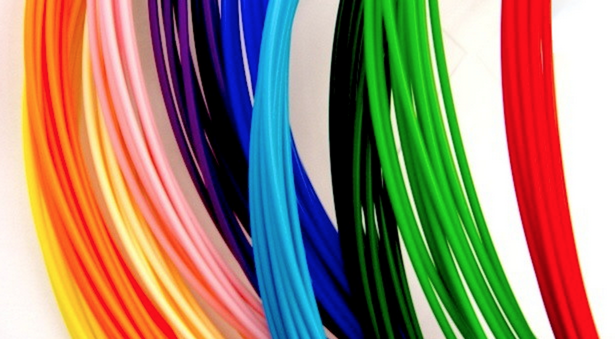

What happens when you don’t store your filament correctly?
colored filaments
They absorb moisture from the air, which degrades its quality over time, causing failed prints, sputtering, and nozzle blockages.
