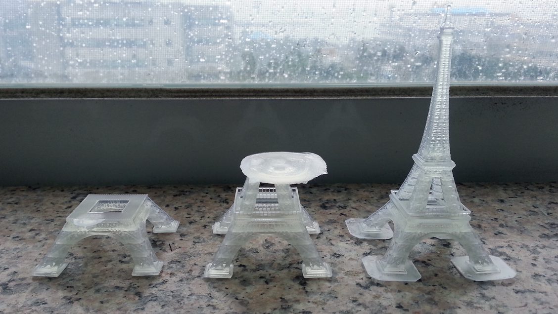

Example of 3d printed trouble models

Broke from supports during print
