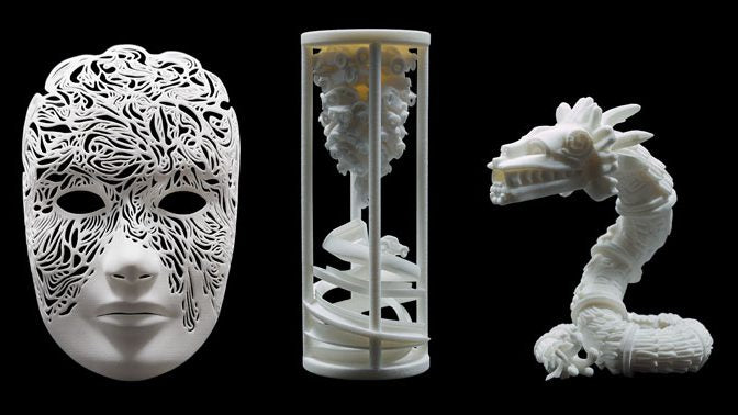

7. Smaller is better
3D printed models
A handy tip for those who are new to 3D printing- Start small. Working on bigger prints that take 6 hours only to have it fail can be very frustrating. Also, do not print several pieces at a time.
When you construct models on your own, it is a good idea to print out the tricky parts separately to test whether they come out as you want them. So you won’t have to throw away the entire model when the tricky part goes wrong.
