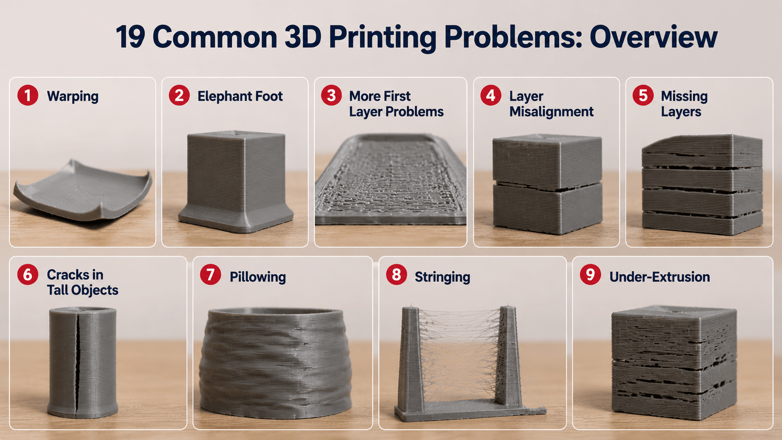

19 Common 3D Printing Problems: Overview
If you don’t know the name of your problem, you can refer to the following 19 problems.
1. Warping
2. Elephant Foot
3. More First Layer Problems
4. Layer Misalignment
5. Missing Layers
6. Cracks in Tall Objects
7. Pillowing
8. Stringing
9. Under-Extrusion
10. Over-Extrusion
11. Shifting Layers
12. Blocked Bowden Nozzle
13. Snapped Filament
14. Stripped Filament
15, Broken Infill
16. Ghosting of the Internal Structure
17. Gaps Between Infill and Outer Wall
18. Non-Manifold Edges
19. Model Overhangs
