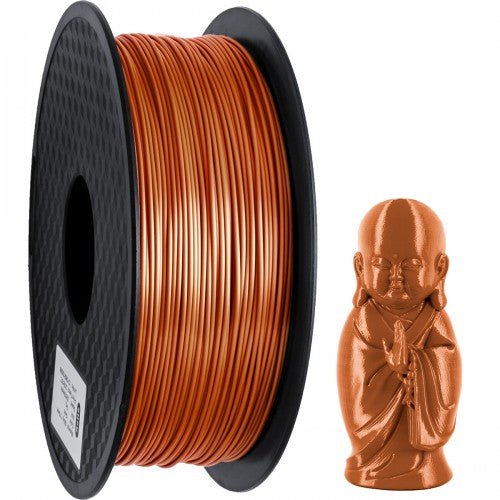

PLA
PLA
Pros:renewable;environmentally-friendly;less likely to warp;well affordable;odorless.
Cons: less durable and flexible;not soluble in esters or ketones
Optimal Temp.: 200°Celsius
Specifications: diameter: 1.75mm/2.85mm
PLA
Editor’s comment: made from sugar cane and corn starch, PLA is easily the most environmentally friendly and affordable material available on the market. Objects created from PLA is of great strength, medium durability and low flexibility. Same as ABS, it is not soluble in esters or ketones. However, unlike ABS,it renders a heated bed redundant(note: having a heated bed still helps). A case in point would be the Geeetech E180,which is specifically designed for educational settings and comes without a heated bed since it uses PLA. Textured paper is used on the build platform to improve adhesion.
