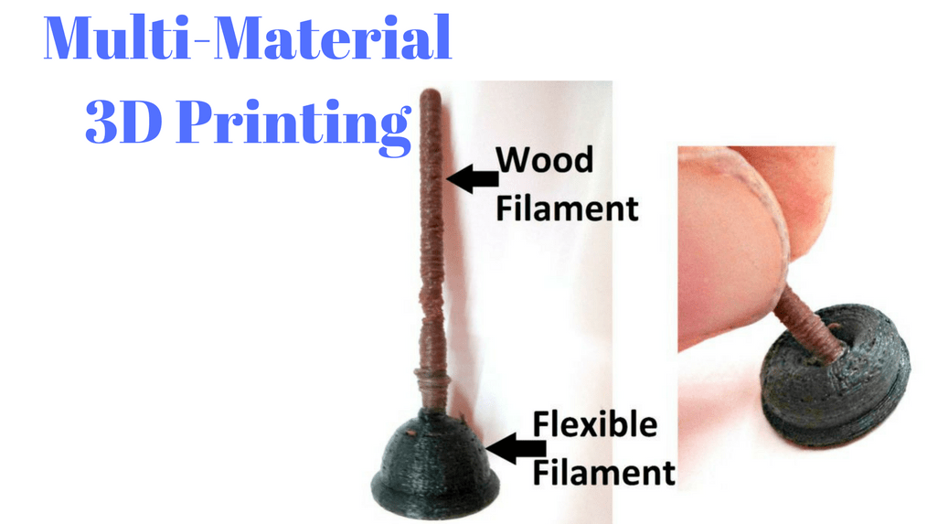

Icecats has explained this really well with an example of printing a toilet plunger, as it has a flexible filament and a wood filament. So you need to find a good 3D model from Thingiverse or MyMiniFactory or any other 3D Printing website. You need to keep certain things in mind like:
  • Choose the object wisely which makes sense of carrying out a multi-material printing process.
  • Keep a certain height within two materials, as this is key to the process like the flexible plunger base is lower than the wooden handle.
  • See whether the model is printable with the desired materials.

Multi-material 3D printed toilet plunger with flexible and wood filaments
  • Monitor the printer as the first material is extruded.
  • When you want to switch the material, just pause the printer; it usually takes a bit of time for the printer to stop. Raise the printer to 10 mm height on the z-axis.
  • To prevent the leakage, you need to place a piece of paper below the extruder. If necessary, adjust the hot end temperature in the Manual Control tab to suit the second material.
  • Switch to your second material and purge the extruder until the new material comes out pure. Remove your piece of paper and continue the print. Repeat this process as many times as necessary.

Icecats tells how his 3D Print resulted; he basically used two different PLA/NinjaFlex and wood/NinjaFlex. He says that both tests worked well for him. The purple and white cylinder shown above was printed with PLA and NinjaFlex. He has stressed that the print until it broke- two PLA layers split apart, which means that the NinjaFlex/PLA bond is actually stronger than the PLA/PLA bond! The bonding between the wood/NinjaFlex was similarly high strength.
