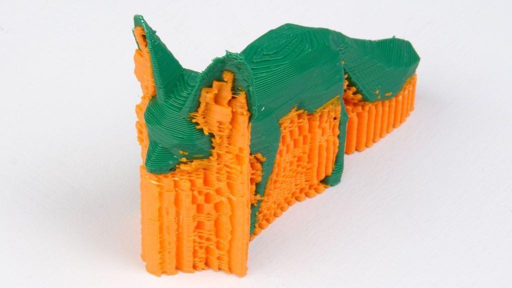

As you continue to model and 3D print various objects, you’ll find that many of them will need support structures to hold the design up. The more complex the object is, the more crucial it is to design a good support structure.
However, on some occasions, you may find your support fails to do its job, resulting in a failed or messy print.
The 3D Printing Support Structure Problem
bad 3D print
While printing your object, you’ll realize that your support doesn’t look as stable as it should. There may be gaps and it may even fall apart or crack in some places. Weak supports are also stringy and overall your print just looks like a hot mess(not in a nice way!)
Why Does It Happen/ Why Support Structure Fail?
Slicer Settings
Most of the time, we tend to stick to the default slicer settings provided by the slicer applications. This may work for standard print jobs. But while printing more complex objects, it is important to change these settings. For objects like supports, use your default slicer. Since the setting will not always work. The more complex the object and overhangs, the more attention you have to pay to the slicer settings.
Type of Support Used
Thinner support structures are easier to remove. But they are not always strong enough and can break apart during your print process. On the other hand, stronger supports are denser but are much harder to pry off. At the same time, thinner supports may move easily if there are any sudden movements or vibrations from the 3D printer itself.
Many a time, tall and intricate prints will have delicate and thin supports so that they come off clean without ruining the print. Though this sounds good in theory, this kind of support doesn’t offer much stability to tall prints. Triangular and grid-shaped supports work better as they add additional structure under large overhangs.
Problem with the Filament
Filaments that are old or cheap are weaker and tend to break more easily which is another reason why your supports don’t hold up. Old and expired filaments won’t bond easily to each other and the structure can tend to have more gaps and cracks. It is necessary to use high-quality filaments.
Lastly, don’t forget to keep an eye on your printer. Many times, there are a few loose screws and nuts that can create vibrations during the print and if your support structures are not strong enough, they will fall apart.
