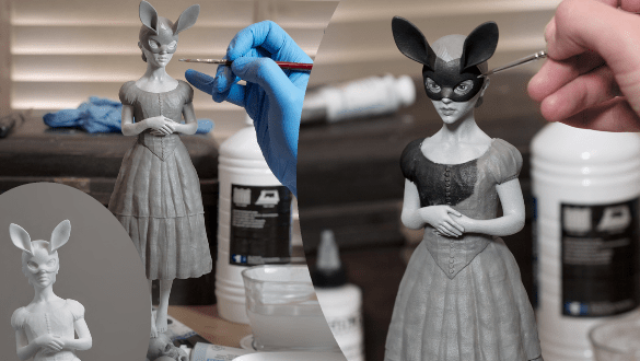

It would be so much better if our 3D-printed objects were removed from the bed too easily and were perfect. But sadly, that’s not the case. For better prints with proper finishing. You need to put in some extra effort even if the print is ready. This is the essential step in 3D Printing. Because you want your 3D prints to look their best. You don’t need to invest too much and the skills and tools are mostly that we use in everyday life. Why it’s so important to give proper finishing to 3D prints? So why leave your 3D Print without giving it a smooth touch?
Nerdforge Youtuber, he has shown the simple things that you can do to make your 3d prints look the best and yes, they won’t even look like they are 3D printed coz the finishing is that fine. Also, in addition to the above video, you can use these extra tips to help you out.
