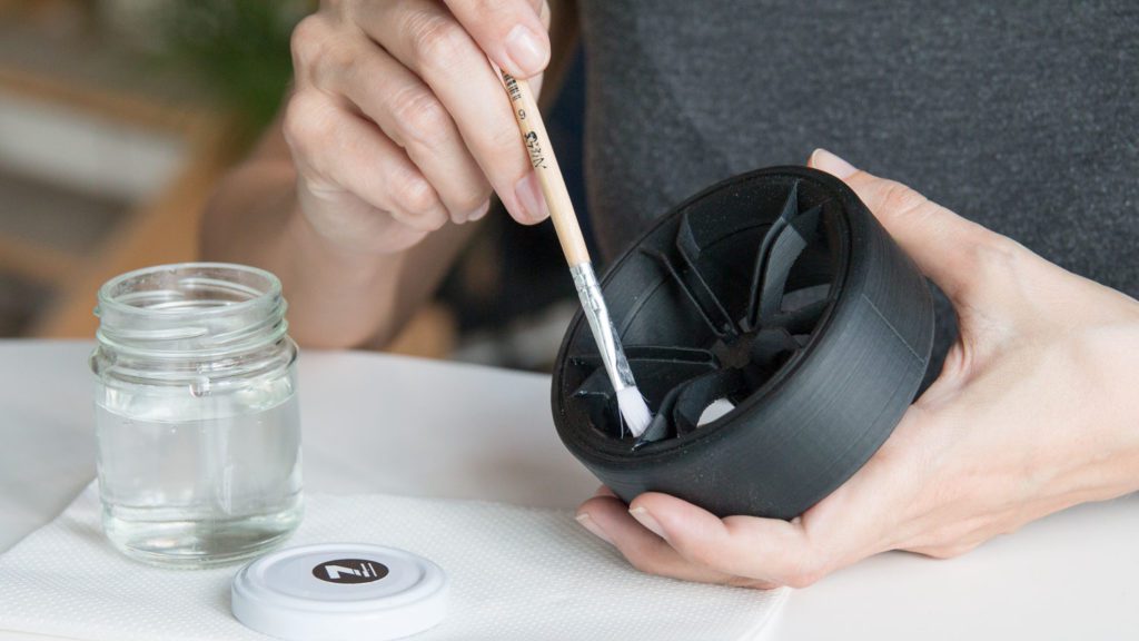

If you’re looking for another medium and super glue just isn’t your thing, then maybe you should consider using a solvent instead. A solvent like Acetone, for example, will let you bond parts essentially, chemically melting them. Just be careful and give your project enough ventilation.
So why is a solvent such a popular pick? Well, with solvent, what is left is just the plastic – nothing added. Also, being a watery liquid, it can drip, seep and draw into places other methods cannot reach.
Most people are aware that ABS can be solvent welded with Acetone, which is commonly found at hardware stores in bulk or drug stores. But what's interesting to learn is that some PLA filaments can be solvent welded with it too! You can experiment with some PLA of your own and find what works best for you. Make sure you use a natural brush rather than one with plastic bristles.
HIPS can be dissolved by limonene, but the modeling solvent Polystyrene can also be used, just like when you build model airplanes! Another advantage of solvent is that, in addition to brushing it on neat, you can use it to fill larger gaps by dissolving some filament for a while to make a thicker consistency.
