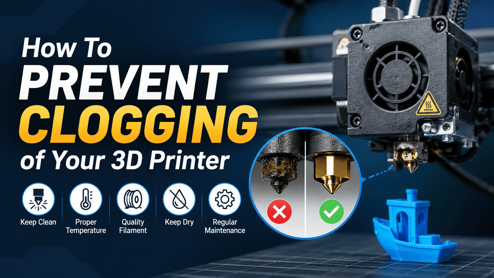

How To Prevent Clogging of Your 3D Printer
I think partial FMD 3D printing lovers have met the same trouble when they are applying to use the machines; getting the nozzle clogged on your printer is quite an annoying yet normal phenomenon. So today, I would love to share my experience on how to avoid trouble based on the theory and my practice of it.
In this article, I will explain to you why and how the nozzle gets clogged while extruding in a stumbled way.
First, the quality of the filament should be the first to bear the brunt. There exist various brands of filaments in this marketplace; some are of rather bad quality while others possess a perfect one. Printing with filaments of bad quality sometimes will cause bad consequences, like coagulation in the place of the nozzle or carbonization of the nozzle. On the other hand, if filaments are stored in any environment of an unsealed package, oxidation or dampness, they can be easily clogged inside the nozzle. I have been using some unused filaments for my printing works for a short period. With those filaments, getting my machine’s nozzle clogged is quite a common issue I faced in every printing work. That’s rather annoying, isn’t it? As a result, I have changed to new filaments that are preserved perfectly (tightly sealed in a perfect environment), and currently, I get my printing work much smoother.
3D printer nozzle clogging example
