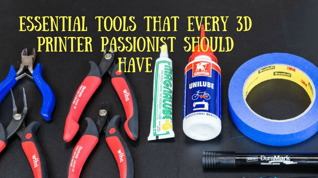

Pliers
A pair of pliers is always good in a kit; it's handy to remove any sticky object or to fix the printer if there is some help needed. Get quality pliers with rubberized slip-resistant grips.
Pliers
No matter what brand you end up buying, the absolute must-haves are needle nose pliers and wire cutting pliers. The wire cutting pliers are particularly useful to snip away support material or when trimming filament.
These can be used to reach into tight spaces to remove tangles or melted material also used to trim filament, larger messes, and any wire or other material used for supporting the printed piece.

Magnalube and Unilube
Sometimes the X and Y axes need to be lubricated to ensure that they run smoothly. The best lubricant to use is Unilube, and all it takes is a single drop to resolve any issues with dryness. For the Z trapezoidal leadscrew, use Magnalube.
It’s important not to use WD40, as this affects the axle coating and can cause damage to your printer.
Masking tape
The most widely used surface covering for the print bed is masking tapes it allows the prints to adhere better. Additionally, the tape also makes removing the finished print easier and it protects your print bed from scratches.
Masking tape
When buying the tape, make sure to select a width of at least 50 mm (2 inches). Wider tape requires fewer strips to cover your print bed, something you will come to appreciate if you resurface your print bed frequently.
Choosing a proper masking tape depends on your preferences and build size. If you regularly print to the full width of the bed, it might make sense to get the wider sheets.
