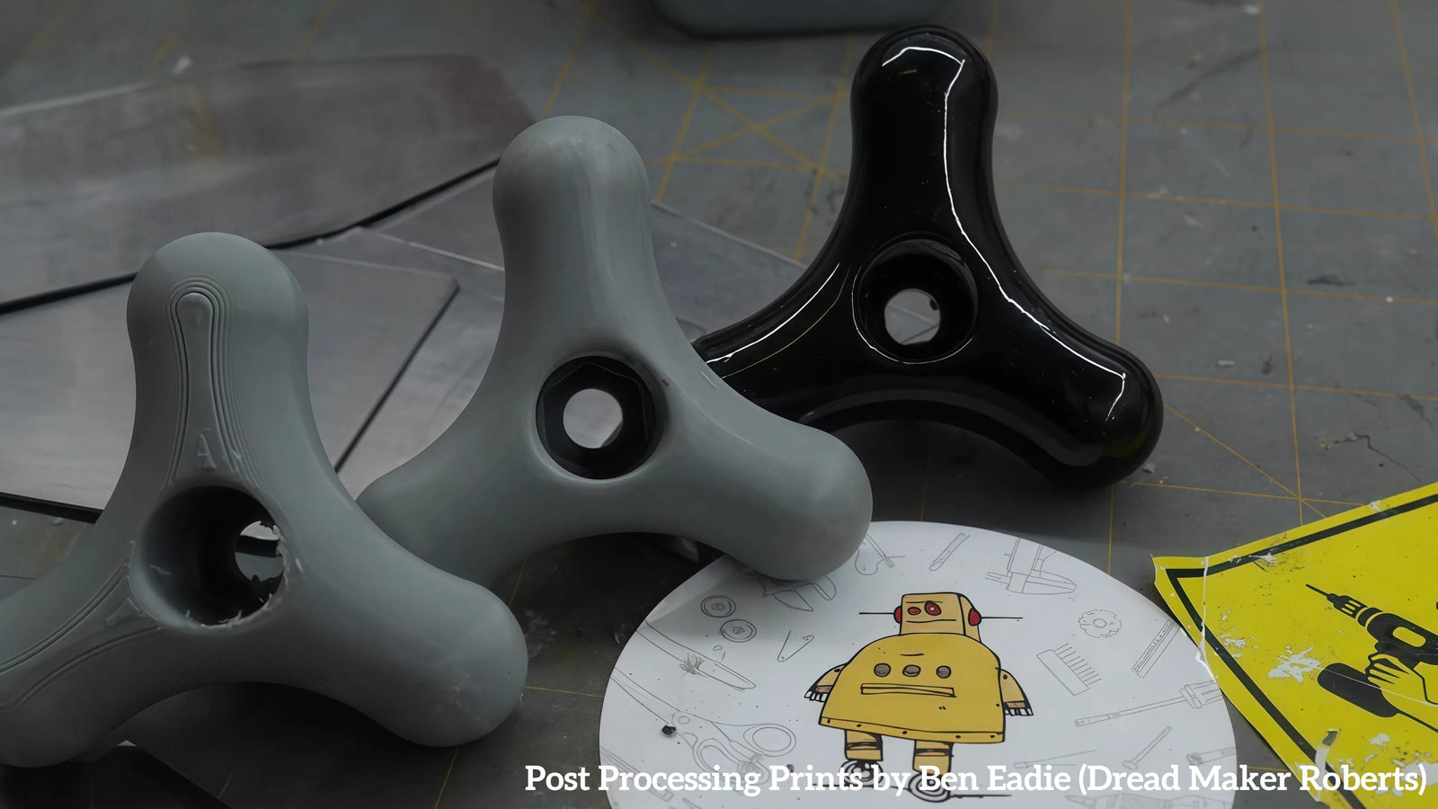

Sand Blasting
Sand blasting is an alternative to sanding where the 3D print is sprayed with fine sand, glass beads or other materials in order to smooth the surface and create a uniform texture. This method requires a careful approach as both PLA and PETG are quite soft and sensitive, and thus can easily be damaged.
