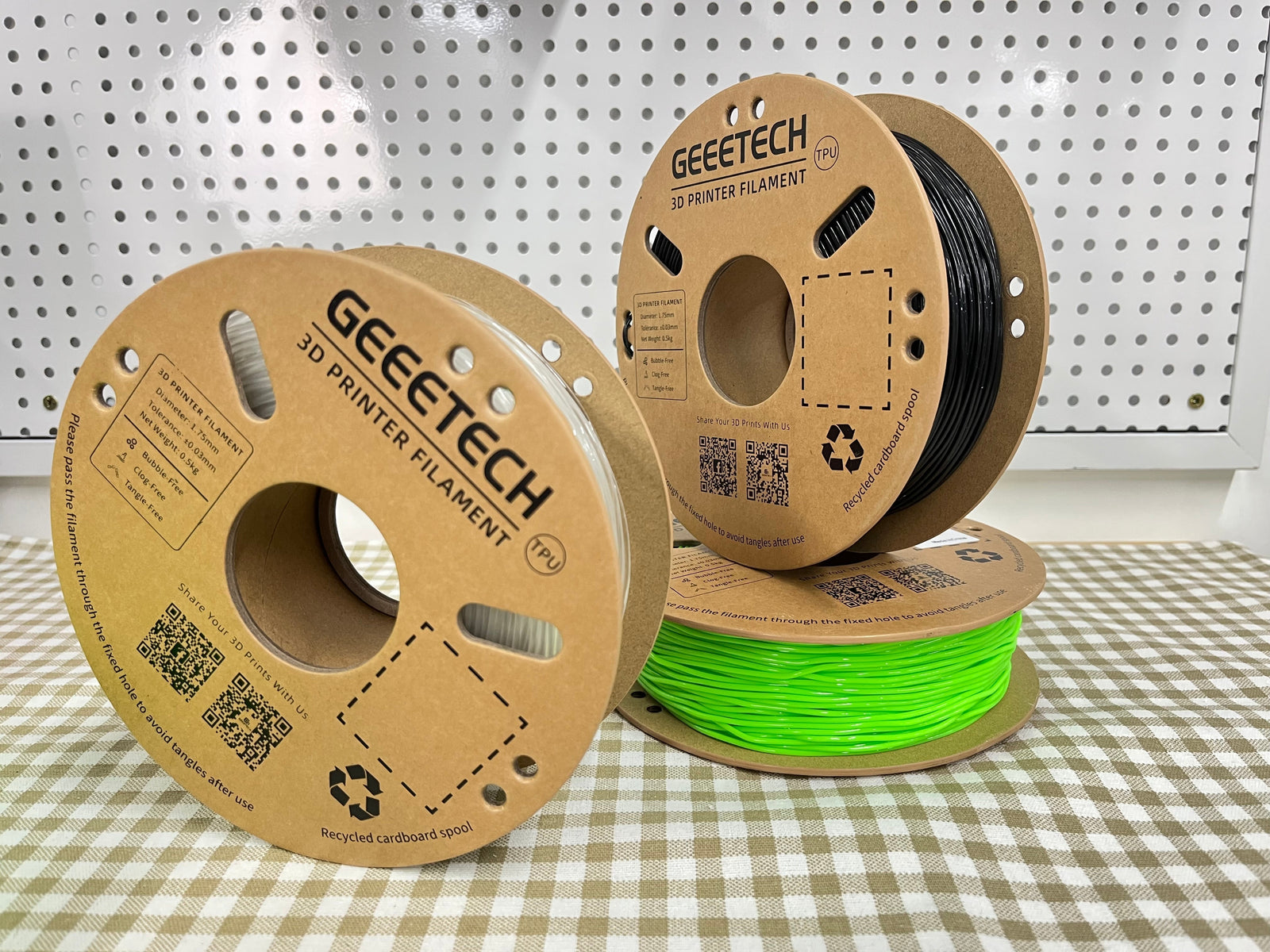

What Is TPU Material?
TPU is a thermoplastic 3D filament that is known for its transparency, elasticity and flexibility, as well as being resistant and durable. It is closely related to TPE which is one of the most used types of plastics for consumer products. For an in-depth discussion on the two, please read another blog: TPE VS TPU.
TPU filament does require a bit more attention to detail when choosing 3D printer settings, but other than that, it is a great filament to work with.
