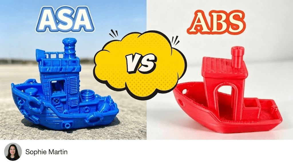

ABS vs ASA 3Dbenchy
ABS and ASA 3Dbenchy
