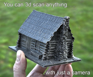

Did you know you can make a 3D printable model out of almost anything using only your camera and some software? In thisInstructable, Whitney Potter, who goes by shapespeare and who also hosts the podcast “3D Printing Today”, brings us some valuable tips about doing just this. Here he uses an Oreo cookie as an example of how to transform an everyday object into a 3D printed one in 17 steps that cover everything you need to know.
