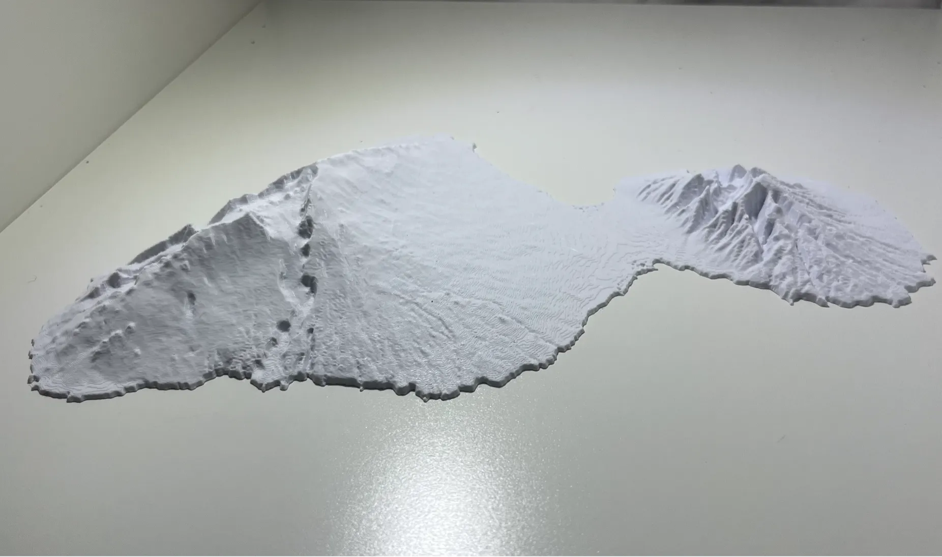

We also recommend that you try geological models of terrain and topology, perhaps an aerial shot or height map of your hometown, for a unique and personalized print that can decorate your favorite area of your home.
3d printed height map by Marble PLA
Height Map (Source: john @Makerworld)
