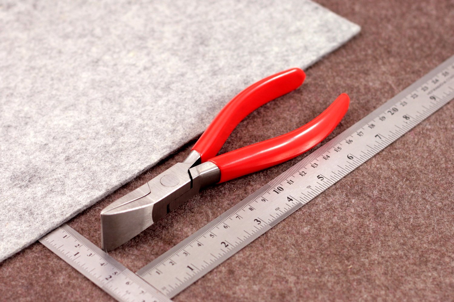

Pliers
A pair of pliers is always good in a kit, its handy to remove any sticky object or to fox the printers if there is some help needed.Get quality pliers with rubberized slip-resistant grips.
No matter what brand you end up buying, the absolute must-haves are needle nose pliers and wire cutting pliers. The wire cutting pliers are particularly useful to snip away support material or when trimming filament.
These can be used to reach into tight spaces to remove tangles or melted material also used to trim filament, larger messes, and any wire or other material used for supporting the printed piece.
