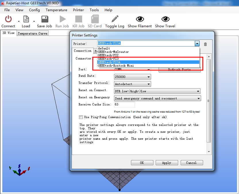

3. Open Repetier Host and ensure that you have a valid port selected for communications. To do this simply, click “Printer Settings” in the upper right-hand corner to bring up the printer settings menu.
4, Select GEEEtech PI3A in “Printer”
5. Select the corresponding COM port, and click OK to continue.
If you can not find the COM port, click “refresh ports” and see if it appears. (It is usually the last one; you can check the device manager to see which port it is). PS: if you still cannot find the port, please reinstall your USB driver.

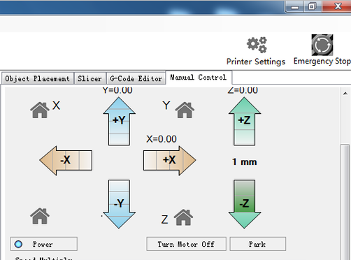

7. On the right panel, click the “Manual Control” tab. Scroll down and click both the heat extruder and heat print bed buttons to activate your heaters. You will know they are on if they turn a bright blue.

8. At the same time, you can click the arrows on the above panel to move the motors to check if they work well.
