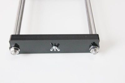

Step1. Slide the rods into the acrylic plate; adjust the length so that the smooth rods fit snugly between the front and rear piece.
Step2. Screw up the rods and plate with M10 nut and M10 washer.
Tips: the Y-axis must be a rectangle, that is the rods on both side should be parallel, so is the front and back plate. Otherwise it will cause obstruction for the belt later. You can use a Digital Caliper to measure. .

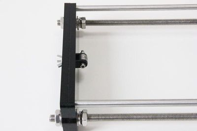

Assemble the Y idler
Required parts Required number Part ID
624ZZ Ball bearing
2
NO.38
bearing holder
1
NO.66
M3 x20 screw
1
NO.27
M3 wing nut
1
NO.15
M3 x25 screw
1
NO.35
M4 lock nut
1
NO.14
Step1. Thread the M3 x 20 screw through thethe bearing holder.
Step2. Put the M4 x25 screw through the holes with the two 624ZZ bearings in between. Lock the other end with a M4 lock nut.
Step3. Mount the assembled bearing holder onto the front support plates. And screw it with a wing nut.
*Please leave enough room for the belt between the ball bearing and the screw.

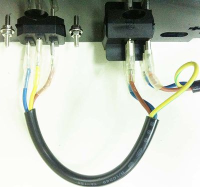

Mount the PSU on the right side panel with 3 M3 x 10 screws.
Then mount the AC socket with M3 x 20 screws.
You have to take off one end of the connectors to get both the power button and the power socket into the hole.
1. Mind the color of the wires. The wrong connection of the wire will cause serious damage to the PSU and even to the control board of the printer.
2. Pay attention to the switch on the right side of the PSU, there are two options of voltage: 110 V and 220V, choose according the standard in your country. As shown in the following picture.
After connection, please close the protective cover to avoid electronic shock.
