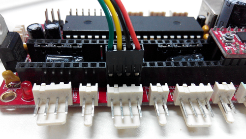

Step4. Connect all the wires to the interfaces of the board
The referring wiring schematic diagram of Sanguinololu
* use the Dupont cable in the package to strech the wire of fan for extruder, you just need to connect the black and red one, leave the yellow one alone.
  • Fan is connected to GND 12V, connect the red wire to "+", and black to "_". For the fan of extruder, you have to use the 2-pin DuPont wire to extend.
also you can refer to the board cover.
For more information about Sanguinololu, please visit the wiki page.
Note: when connect the other Z-motor, use the 4-pin M-F DuPont cable and pay attention to the directions of the wire. If you connect them reversely, the 2 Z motor will move in different directions.
Look at the colors of the wire.
