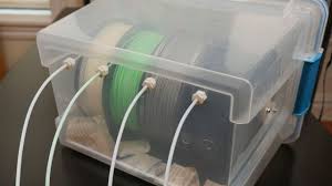

DIY filament storage
DIY filament storage- 3D Printed filament
These are the DIY filament storage that can be modified whenever required Src : instructables.com
There are several DIY storage solutions that can be used for both storing and to print directly from the container. These can be modified using any equipment or features you require at that point. But don’t forget to install the spool holding and a coupling for a Bowden Tube. Also, make sure that the containers are huge enough and coupling is airtight to keep the spool safe when not printing.
