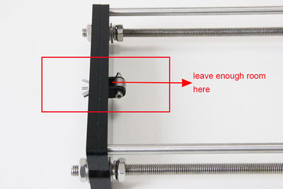

Assemble the Y idler
Required parts Required number Part ID
624ZZ Ball bearing
2
NO.38
bearing holder
1
NO.66
M3 x20 screw
1
NO.27
M3 wing nut
1
NO.15
M3 x25 screw
1
NO.35
M4 lock nut
1
NO.14
Step1. Thread the M3 x 20 screw through thethe bearing holder.
Step2. Put the M4 x25 screw through the holes with the two 624ZZ bearings in between. Lock the other end with a M4 lock nut.
Step3. Mount the assembled bearing holder onto the front support plates. And screw it with a wing nut.
*Please leave enough room for the belt between the ball bearing and the screw.
